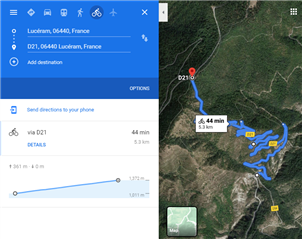

  • Btw, I just drew the course on Google Maps, for even another separate comparison. Lo and behold, they report 363 m of elevation gain and 0 m of elevation loss. This reported elevation gain is right around that 340-360 m range reported by two bike computers with barometers and by other navigational tools, and, importantly, the numbers (and the elevation profile graph) correspond to what you see if you are on site, i.e. a steady climb with zero elevation loss. Again, it's an ocean away from the 647 m elevation gain and 275 m elevation loss reported by Garmin for the same segment. If using the 350 m mark as a reference, for this road, Garmin overestimates the elevation gain by 85%. In terms of accuracy and validity of the Garmin Connect elevation numbers, there is no other word for this than horrendous.
