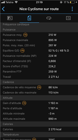

    Cheers Mike. In the Nice activity, it seems to have kept the altitude gain from the Forerunner file, and overreads by almost 800m, while the average power is 10W higher than in the individual bike file. Any idea how/why that occurred?

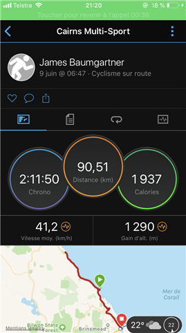

    I may have uploaded the wrong file, but the cairns bike is missing just over half an hour, and elevation seems to be wrong on that too, perhaps taken off the watch instead of the garmin?

  • Former Member - I have checked the Nice bike file that you provided and it had an avg pwr of 220W, which transferred into the fixed file.  I have run this file through the GPS elevation correction feature in FFRT so upload it and see if the altitude gain is any better.
    The Cairns bike file you provided had an elapsed time of 2hr47min01sec - does that sound right?

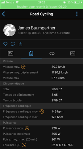

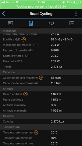

    Here’s a screenshot of the Nice bike recording off the Garmin Edge (ignore it being in French), showing 210W and 1192m elev gain.
    Here is a screenshot of the file you fixed for me today with elevation corrections - average moving speed of 1790km/h, moving time of 3:05, avg power 220W, elev of 1821.
    The file from cairns is about 2:47, but the screenshot of the bike leg from the file you sent me is below. Not sure what happens to the time and elevation when they’re edited.
