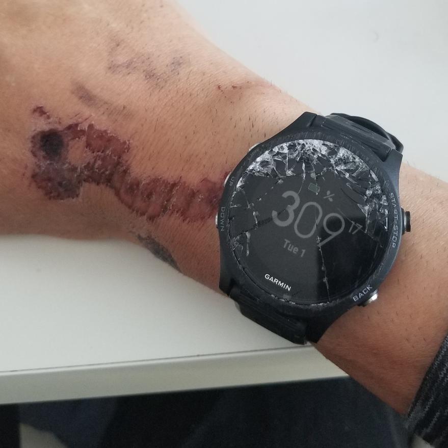

  • Ironman Texas 2018. Had a bike crash which the watch and I somehow survived, and were able to get through to the finish. BUT it died before saving the event despite recording ALL the data!
    Pretty sure the data is there after downloading a demo of fitfilerepairtool. Fit file here: https://drive.google.com/open?id=1Lee_D0FgH5Hqxk6TOEldVBb1-k5eyXHy
    Appreciate anyone who has the resources to repair the file for Garmin/Training Peaks / Strava upload.
    (ALL the data = Garmin 935 / Power2Max Power Meter / GLONASS-GPS / Stryd footpod for speed-distance)ciq.forums.garmin.com/.../1342214.jpg

    hi nbrowne1,
    Definitely one of the more time consuming repairs I have done - there was an absolute TON of data in that file and I've had to use every second data record in order to be able to do the repair.
    Give this file a try.
    cheers
    Mike
  • Thanks Mike! I'm a kiwi too, now living in Canada. Like I said, the file had ALL the data! And over 9.5hrs it's going to be a lot of data to process.
    Really appreciate the work you put in, and giving me the memory of the event. Turns out I was on the side of the road after bike crash for 40min instead of 30min like my bike computer suggested.
    https://connect.garmin.com/modern/activity/2668424538/1
    Thanks again!!
