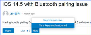

If you're referring to notifications, on the original post, click more then select "Turn Reply notifications off."
If you reply again to the thread or upvote a post, then notifications get turned on automatically, so you'd have to turn them off again.
