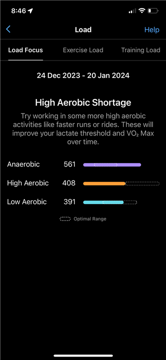

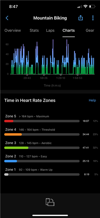

I have couple weeks been using Fenix 6s Pro and I don't get any "high aerobic" numbers to the training load focus, regardless of the training I do instead. Instead they are either low aerobic or then if speed up, it gives instantly anaerobic points, even if my heart rate has been much of the training in high aerobic zone.. Any suggestions what could be wrong here?

  • I have exactly the same problem.  I used to have anaerobic,  low and high aerobic load doing a variety of exercise  - wattbike, skipping, weights, gravel & mtb - long and short rides, flat & hilly. Since start of year I only have low aeroibic. Was HRV status introduced on frnix 6 at same time. Something has definitely changed
  • I have the same issue, but has only appeared after a 4 day mountain bike ride (KAW) so my figures are high as it's a tough ride, I only wore my watch and not my HRM so you can eliminate that from the issue, nothing else has changed, I used to have the high aerobic figures before this event. I would like to add my current HRV has become unbalanced and I would expect this to return to normal after another rest day

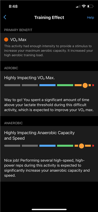

  • I’ve got a similar issue. In charts I can see I’m getting high aerobic time in but load focus shows nothing. I’ve also done 1.5 hr ride with it showing as the activity for the day but having no effect on my training load,  as if I didn’t ride. Do I need an update, if so, how?
