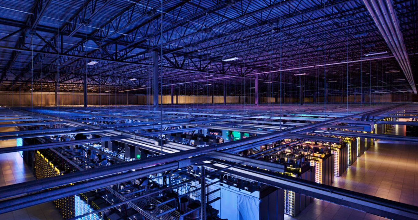

    Soooo, you would like BaseCamp to respond as quickly as Google search. Okay here is what you do, go to your local Apple Store and purchase 1.5 million Mac Pro Quad Core's with 64GB of memory each. That will give you about 1/10th as many CPU's and memory as Google has dedicated to Map Address Searching. Oh, can't quite swing that? Okay, then you could try one of these methods: ;)

    Just part of just one of Googles Data Centers. DRTBYK was about right with the numbers.
