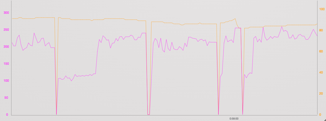

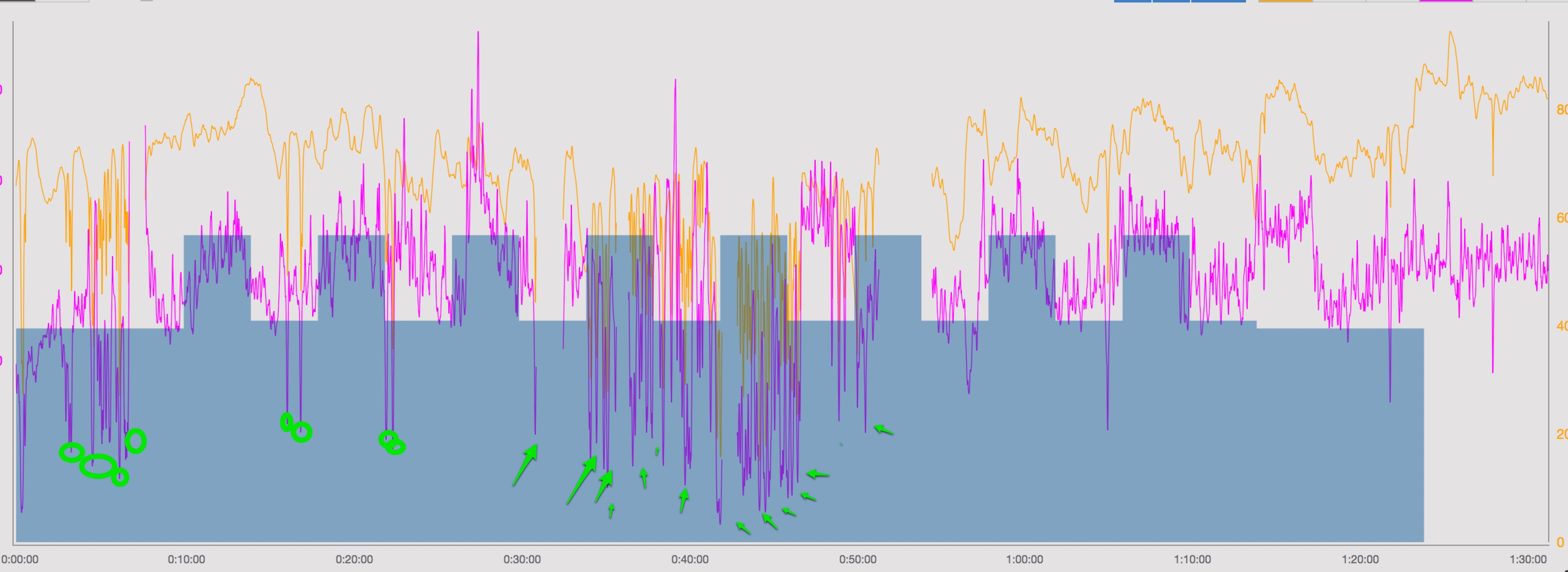

    Hi, I have been having a similar issue with my Vector 3 pedals when using the pedals on the turbo with Zwift where the power occasionally drops. The cadence will drop to zero for a second or two and the power will drop to around half of what I was riding at, after a few seconds the numbers will return to normal. However, once this happens once on a ride it then keeps on happening. Sometimes it happens from the beginning of a ride and other times it will not happen until an hour or two in.
    I have looked at the files in Training Peaks and you can see the points where the power drops are happening. None of my other ANT+ sensors drop out when the power dropouts happen, so it is unlikely to be a ANT+ drop. I use a Wahoo KICKR trainer and it works perfectly with Zwift with no power drops. I have only used the pedals outside on a couple of rides, on one of the rides I did get messages on my Garmin 1030 that the right pedal could not be found. I think the issue may be with the right side pedal not communicating with the left, or losing signal. I have tried three different sets of batteries. Firmware is up to date.
    Hope you can help, I tried contacting the online support centre chat, they had to ask what Zwift was!
    Thanks.

    I',m having the EXACT same problem.... Yesterday indoor training was a disaster.... During one 1hour, many episodes of zero cadence and power...
    Garmin ??
