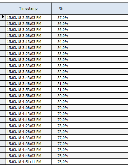

  • I did ride two days ago, almost 2 hours, using Edge 520 (v 12.5), Stages PM, and Garmin HRM. Battery took only 11% (from 87% to 76%) charge. Fit file included in the attachment.ciq.forums.garmin.com/.../1323462.png
    Wow. I wish my 520 had that battery consumption. I did a 3.5 hour ride outside the other day. Stages PM, Wahoo HRM and followed a course. GPS only with no backlight on and no bluetooth. Started at 100%, went down to 20% by the end.

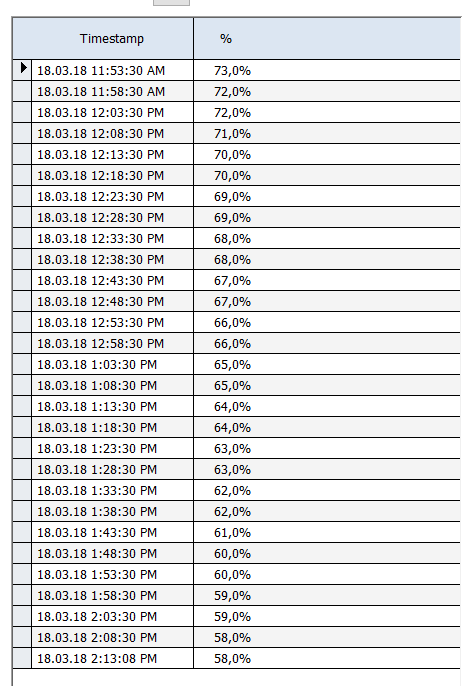

  • Upgraded to beta firmware, 12.53 and did almost same ride. 2:19:12 took 15% battery.
