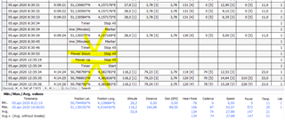

At some point mid ride my Edge just crashed and did a forced reset. Now I've known this to happen from time to time on my Edge 800 as well but it was never a big deal... you just restart the device and ride on and everything is fine, at most you lost a km of data from where the Edge 800 froze up and rebooted. As far as I could see yesterday during the ride, this was the same problem. However once I got home and uploaded my ride to Garmin Connect/Strava it seemed half the ride was gone and the device just pulled a straight line over the map from the last point where I rebooted my edge (early on to try and fix the navigation issues (which failed) all the way up to the point where the device crashed).(https://connect.garmin.com/modern/activity/4742087498)
Now, some things are still there, like the distance and moving time and everything. That information is correct. But all power & heart rate data from that 3 hour window has been clipped, this does also greatly impact on my training metrics which annoys me even more.
So... does anybody know of any way to do some sort of recovery to fix the file in it's original status?
