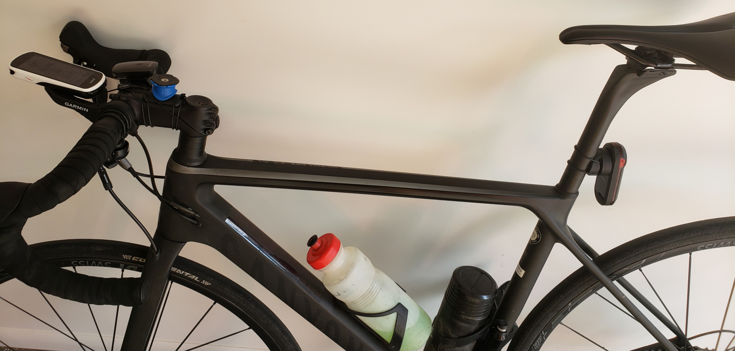

I have had an issue with alert sounds since purchasing the RTL510,
with my CANYON ULTIMATE the alert is barely hearable or not at all, had the 1030 replaced without any improvements,

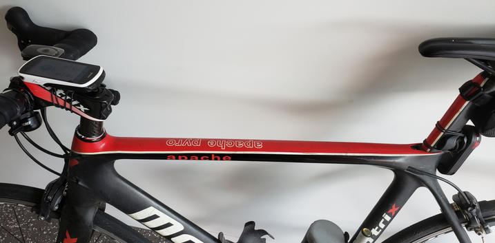

done some tests now over the past 2 weeks and noticed when I use the 1030 and RTL 510 on my other bike (MATRIX APACHE), I can hear the alerts very loud and clear.
thought at first it is because the Matrix uses a regular Edge mount, but then tried a regular mount on my Canyon, still can not hear it.
not sure what the reason is but this is definitely an issue,
again it works with the MATRIX Bike but not with the Canyon,

    did many experiments and can now narrow the problem down to the distance between the edge and the RTL510,
    in my case it works better if the distance is around 600mm,   640mm reduces the volume, with 740mm (flyout mount)  no more sound
    I reported it to Garmin and suggest everyone else with this problem should do the the same (see Garmin response below), Garmin can not fix it without good user feedback

  • I have finally had some success,
    made a backplate up for the garmin flyout mount that fits into the spare battery connection of the flyout ,
    it has the width of the edge 1030 in my case and is right underneath the 2 speaker holes, with about a 2-3 mm gap between the edge and the backplate.
    anyway it works, now have to design something slicker to make it look good

  • Sorry, you are correct, it has 4 small holes,
    anyway it improved the sound on both of my bikes, could not hear it at all on one of them, because the flyout is further away from stem than on the other,  try it and you will hear the difference, I was sceptical as well before I tried it
