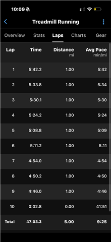

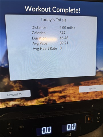

  • Am I the only one that my Garmin is listing slower than the actual pace?  Everyone else seems like there's is much faster.  I installed the Beta this weekend and ran Tuesday on a treadmill.  It was still way off, showing a 16:00 pace instead of the 9:40 the treadmill stated.  I had it calibrate and am going to run another 4 miles on the treadmill today, so we'll see if it does any better after calibration.
  • It's unbelievable that this company messed up this badly. A $700 fitness tracker that specializes in running can't track treadmill anymore. Tarnishes their reputation. I was going to switch to my old FR55 for treadmill, but it's so old the battery won't last a 30 min activity. But I can confirm a chest strap is a good workaround. I have an HRM Pro Plus. Enable pace/ distance in Connect. I start the treadmill activity on the watch and laid it in the cup holder. Accuracy was almost perfect. Calibrated a delta of 0.01 miles on a 4 mile run. Download HR data. Then save activity. Glancing at the watch during the run, distance was good but real-time pace was displayed as all over the place. Reviewing in Connect, pace per mile was correct. I don't know what would happen if I actually wore the watch at the same time. Anyone tried that?
