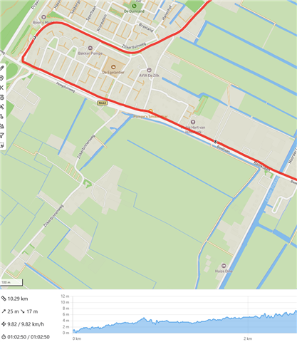

Recently, I noticed that quite often (30% of my running activities) the Forerunner 570 is reporting wrongly the actual distance and my pace consequently.
The proof is that exporting the .GPX file to any viewer (like https://gpx.studio/ ), the discrepancy between the total distance in the watch and this website is in the order of 400-500 meters in 10km running session. It is certainly a software processing problem of the GNSS live data in the watch, because the accuracy on the registered data (.GPX) is rather accurate when shown in the web application, see below.
For completeness, this problem is appearing either with "Satellite setting - GPS only" or with "Satellite setting - All systems".
Are you aware of this software problem? Have you any suggestions to fix it ?

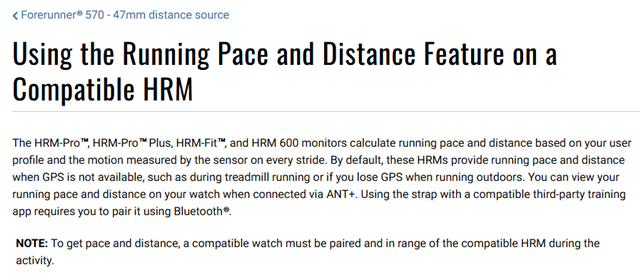

    The issue was that my HRM-Pro was set as the source for the running pace and distance ....
    According to the article below, the HRM-Pro is providing by default running pace and distance when GPS is not available, such as during treadmill running or if you lose GPS when running outdoors.
    However, according to the Gamin Support, my activities were all using always the HRM info and not the GPS in the watch.
    This explains why the GPX file is not aligned with the Garmin Connect visualization.
    Today I ran without the HRM setting for providing running distance, and the watch information has been really good. Honestly, I think that it is a software bug that is overriding always the GPS from the watch with the HRM sensors.
    Anyway ... If you have the same accuracy issues, please disable the HRM-Pro data !
    Ciao, Stefano
