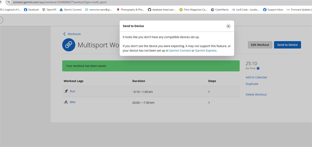

I can't get multisport activities planned in Garmin Connect (app and web) onto my Forerunner 265 watch. I easily created a multisport activity directly on the watch, but when I create one with the exercises on the website/app, it shows my watch as incompatible. Does anyone know why this happens?

    The video below shows the mode that doesn't work (I used random values and exercises for demonstration purposes only):

    P.S: I just tested it and no multisport workout can be sent to my watch via Garmin Connect (app or web). I set it up in several different ways and none of them show my watch as compatible.
  •  Where does it say that your device is not compatible? Does the workout never show on the watch or is it a pop up that you see on the web/app?
    Here:

    The 265 is not on the compatibility list for multisport workouts.

  • The pop-up that appears at the end of every upload attempt is the same for any multi-sport activity. I thought it was just mine in particular, but any of them that I create and try to upload bring up the same pop-up from the video saying I don't have wearables compatible with the feature (even though I can set them up directly on the watch, just without as many details).

      With the specs stating Triathlon that means that you can add this activity profile on the watch, but custom triathlon workouts won't be compatible to send over from the web/app. Here is the current list of devices that are compatible with sending custom triathlon workouts over to the device:
    • D2 Mach 2
    • D2 Mach 2 Pro
    • Enduro 3
    • fēnix 8 - AMOLED Edition | fēnix 8 - Solar Edition
    • fēnix 8 Pro - AMOLED | fēnix 8 Pro - MicroLED
    • fēnix E
    • Forerunner 570
    • Forerunner 970
    • quatix 8
    • quatix 8 Pro
    • tactix 8 - AMOLED | tactix 8 - Solar | tactix 8 - Cerakote Edition
    • Venu 4
    • Venu X1
