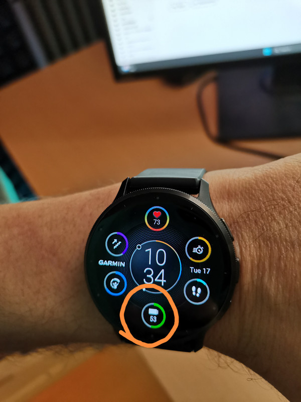

Before 7.0.7, the estimated days on battery worked fine. After 7.0.7 was installed, it only show percentage and not day. The "battery est." toggle is ON. Using original watch face.
Mine works fine on 7.0.7.
You mention your watchface, but for me it's part of the Glance screen when you swipe up from your watchface. Watchface shouldn't matter.
You could try disabling and then enabling those battery manager settings again + reboot of your watch. Good luck.
See image here of what I mean. It shows % and not days. Before the latest firmware, it showed remaining days inside this circle.
Ah that clears things up. That's an issue of the watchface then. That exact watchface also only shows the percentage for me.
The settings from the battery manager menu (with the toggles for percentage and battery est) have no influence on the data fields of a watchface.
I'm not sure of Garmin changed something in the watchface or if it doesn't properly support the new watch version. Only Garmin can fix this... Or you'll have to find a custom watchface which integrates this.
I'm using the watchface 'Easy Round' myself. The paid version has the option for estimated days, but it comes with a lot more customizations. I mainly use this one so that I can use an Open Weather API key for better temperature results than the standard Garmin Weather supplies.
On the previous version, it worked fine, but maybe they removed this option. On the previous version (on the same watch face) it said 9 D or something (9 days). This is an original garmin watch face so my guess is that this is a bug.
So, you have remaining days on this watch face?
