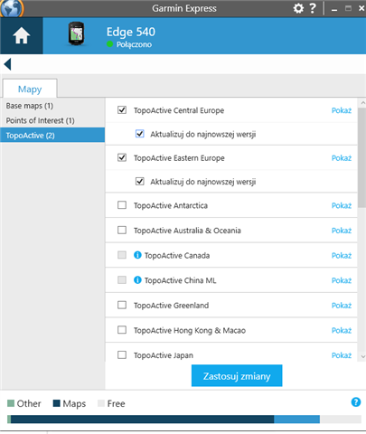

I would like to share some feedback regarding the process of updating maps on my Garmin Edge 540 Solar.
Device: Garmin Edge 54, FW 31.31
Garmin Express Version: 7.29.0+46140687
Map Region: TopoActive Central and Eastern Europe
First and foremost, I was unable to update the maps initially because the device reported it was out of space, even though it initially indicated there was enough storage available. I had to manually remove the existing maps and associated files from the SID and SQL folders to clear sufficient space.
After performing this manual cleanup, I reinstalled the Central and Eastern Europe maps (version 2025). Garmin Express then detected an update to version 2026.11, which I was able to install successfully.

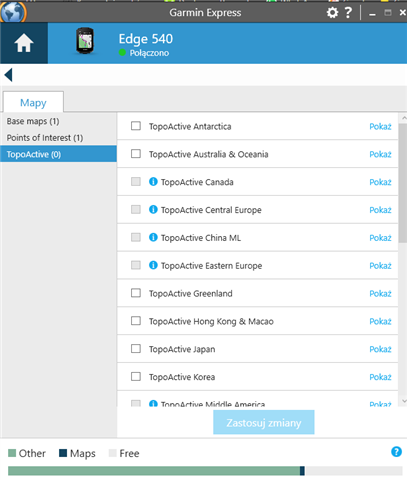

However, after installing these latest maps, Garmin Express no longer recognizes them, and the occupied space on the device is now incorrectly categorized as "Other."
I am not seeking technical support for this issue; rather, I am providing this feedback to the Garmin team to point out that the update process was not seamless.
Additionally, since the latest maps are not being detected by Garmin Express, I am unsure how to remove them other than by manually deleting files from the internal storage again.
Note: Some people recommend removing GarminDevice.xml file to resolve the "other" maps issue. This did not help in my case.
  • Had the same issue:
    -Garmin Express shown to update 2026.11 as available, so I updated
    - then the available space was almost full, so I checked what maps I have available on device and to my surprise there were both versions installed and enabled
    - Garmin Express was not able to remove previous version, I had to do it manually. I actually removed all maps files and then was able to cleanly install 2026.11
