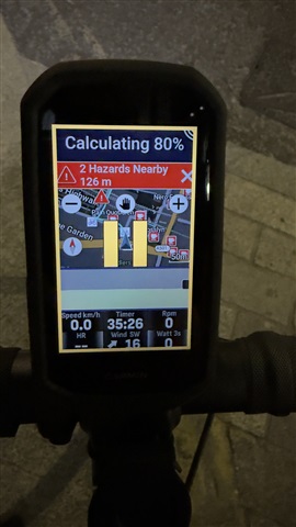

Edge 1050 third consecutive reboot during navigation
I am on the latest stable release with my just purchased Edge 1050.
I have a Varia UT800 and the new Varia radar connected.
For the third time in a row it tries to recalculate the route and gets stuck at 80%. It then becomes unresponsive and requires a hard reboot.
Extremely disappointed that a mature product continue to be as unstable…anyone else experiencing this???
  • The result is this screen that even a force reboot doesn’t fix. The Garmin reboots, lets me start another activity and results in the same issue immediately after the route starts loading.
    Here is what I now call the screen of death
  • Is there a RAM.zip in the
    Garmin\Debug\dump folder?

  • Have the same issue !
    I was doing a 6 days bikepacking trip and the device stop working after 3 days ! keeps rebooting when calculating.
    I had this issue already in the past.
    Garmin support asked to :
    - update to the latest version
    - factory reset
    - do not import GPX and use only Geramin Connect > !!!!
    I just want a device that works straight away without starting to debug, reset, ... and do any particular action.
    A pain, this device is not reliable. For this cost, this is unacceptable, in particular the last point.
  • same here ,same in a bikepacking ride...I loaded 650km GPX file ..now I try to split long rides in multiple ones.  But yesterday crashed without any navigation....very annoying
  • did you already applied the suggestions of Garmin support and the device reboot the same?
  • I have seen similar reports with route recalculation getting stuck and having to hard reboot the device every time would definitely be frustrating especially on a brand-new Edge 1050.
    Since you are running the latest stable firmware I would try disconnecting the Varia devices temporarily and testing route recalculation without them. If it still freezes around 80%, that would point more toward the routing/firmware side rather than the radar or light connection.
    It might also be worth doing a full sync and checking whether Garmin has released a newer firmware update since you last updated. If others are seeing the exact same 80% freeze, it would be useful to compare firmware versions and whether they are using the same map/route settings.
  • Thanks for your reply,
    I'm running the lastest firware.
    I have this issue since the i purchased the device one year ago, with different firware version, with different routes/maps. No Varia devices connected at all.
    I've asked for a reimbursement. I need something reliable.
    Cheers
