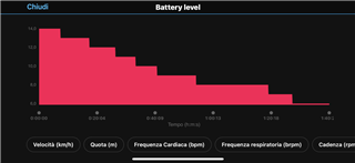

  • Good morning, I did other tests.
    Always with Auto and Always on on screen.
    Even today 9% of battery consumption in 1:30h.
    I go out early in the morning without the sun with a lot of shadow and light alternating.
    In fact, a lot of consumption occurs in the first hour before the sun rises.
    My total battery life estimate is 28 hours maximum.
