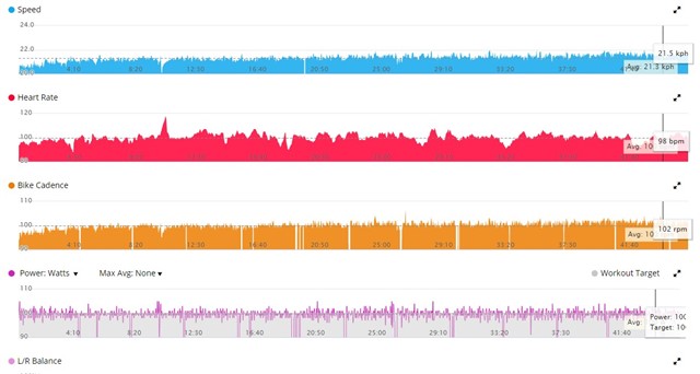

  • Thanks for the tip & the link. I wish the fix was that simple. My 2.4 GHz WiFi is on Channel 1. I even tried disabling it completely & still getting regular Power & Cadence dropouts though Speed is totally fine. When I say regular I mean apart from a few occasions the dropouts occur at around 3m40s intervals
    I don't get any dropouts on my Fenix 6 (ANT+ sensors), Edge 800 (ANT+ sensors) or on the Tacx Android App (BT Sensors). The only difference is that the Edge 1030 has a trainer sensor pairing to my Neo2T for FE-C control as I do my own ERG workouts & don't rely on Zwift etc. to control the trainer.
    Below is today's trainer ride with Beta F/W 9.25. Half way though the workout the Edge totally lost the Neo2T connection & I had to stop the timer, power cycle the Edge & Re-pair it again.
    After that because I'd rebooted the Edge my workout got screwed up & the Edge wouldn't advance to the next workout step when the step timer completed & I had to press the lap key to get it to advance at least when it did advance the Edge did set the Neo to the correct target power
