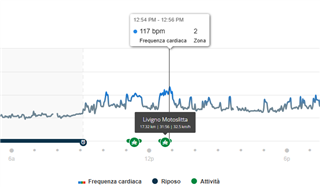

For the first topic, as you can see in the images attached, there is a gap in the monitoring, one while I'm sleeping and one in the afternoon. My question is, is this normal? Do I have to do something to fix this? What I know is that the watch is all the time tight and adherent to my wrist as indicated in the Garmin manual, during the day as while I'm sleeping.
For the second topic, I noticed that the max heart rate during the day doesn't match the max heart rate while i'm doing an activity. Isn't the max heart rate during the day supposed to match the one with the max bpm of an activity the same day? Is this a bug or am I missing something?
As you can see the daily max bpm was 117 but I had an activity (the one on the right) where I reached 146 bpm.

    No, it is not normal. I do not have any gaps in my HR data unless I remove the watch from my wrist. There may be two possible reasons - either the sensor cannot detect your HR for some reason, or the syncing of the data failed. Seeing the relatively short gaps, the first case is more likely. Restricted blood flow may be perhaps the cause.
    i noticed that the max heart rate during the day doesn't match the max heart rate while i'm doing an activity.
    Unlike the first issue, this is indeed normal. The daily HR shows the data averaged to 2 minute interval, which will of course remove any peaks of HR shorter than 2 minutes.

  • Thank you Trux this link was very helpful, don't know how I missed it.
