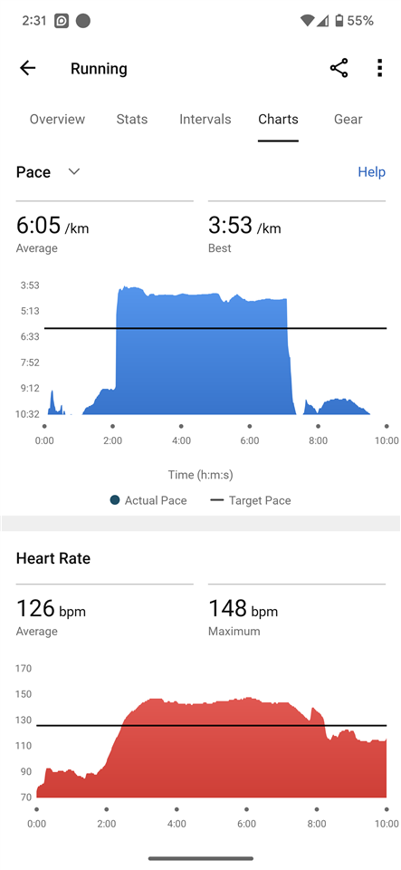

These are 2 Garmin Coach benchmark runs, 3 hours apart. Pretty much identical pace for the 5 min run, yet average HR in the first run was some 20 bpm lower. Higher HR matched Fitbit...and RPE.

  • Pretty much identical pace for the 5 min run, yet average HR in the first run was some 20 bpm lower.
    Same temperature too? That can have a great impact, as well as the fatigue from the first run too. If you want to be sure, use a HRM chest strap. That avoids cases of cadence lock, common with optical sensors.
  • Just checked, less than a degree difference. No rain or large pressure or humidity variation either.
    I understand few beats difference but a consistent 20 lower was not expected.
  • Pretty much identical pace for the 5 min run, yet average HR in the first run was some 20 bpm lower. Higher
    15s/min difference is not “pretty much identical” especially if the runs are not too far apart so the difference in HR could well be reasonable.
  • 15s/min difference is not “pretty much identical”
    Average pace is skewed by the walk either side but the 5 min run pace was 4:23 and 4:21 m/km, respectively for 2 runs, so pretty much identical I would say. The major 20 bpm difference I am referring to is during the run portion of the test. I had Fitbit on the other hand for both runs and HR on that shows very similar trend with 160+bpm for both runs.
    I may be a beginner runner but do have plenty of cycling experience so I am in touch with my fitness and RPE scale. I have done enough runs so far to know that 4:20 pace is not my comfortable aerobic run. I wish!
    The reason for second benchmark test was the first Garmin Coach was fired as he had me running 30min non-stop at 5-5:30 pace in the first week. No wonder, given it just saw me run a km at sub 4:30 pace. The 5 min pace for 30 min is my end goal!
    Since, forums have revealed plenty of stories of consistent and sporadic low HR data issues across all models. :(
