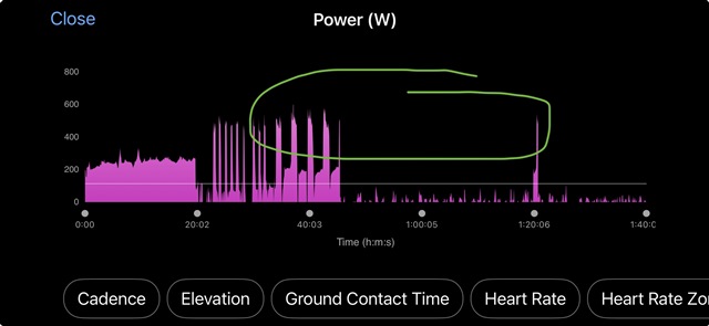

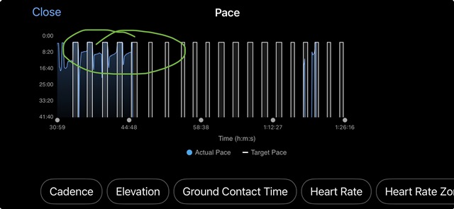

    Today I notice that as the 'pace' as  the 'lap pace' options don't work,
    Today the watch work only in the first four intervals, after this register a 0:00 pace
    the pace is not recorded
    the power is not recorded

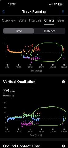

    the stride lenhth is not recorded
    The vertical ratio is not recorded
    The vertical oscillation is not recorded
