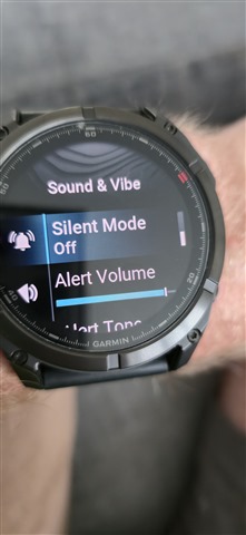

We have tested this in house and have found a setting that will cause the voice alert to stop. Under Watch Settings select Sound & Vibe, you will want to ensure that Silent Mode is set to off, and your System and Voice volumes are turned up. You will also want to ensure that the time alert under System Alerts did not got toggled off in error. If you continue to see this occur please share some pictures of your device settings matching what I've mentioned above.
All those settings are correct,this morning i played golf and when the activity was running on the watch the hourly voice worked.
