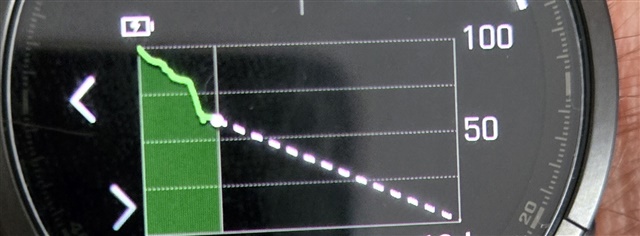

Noticed a sudden battery drain overnight and during the run. The setting have remained same. Sleep tracking with pulse oximeter and hr monitor. No AOD.

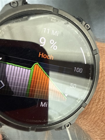

Same issue here with the Fenix 8, 51MM, Solar with Firmware 22.38. I did not change any setting or other behavior. The battery is completely drained within 7d (incl. workouts and listening to music…

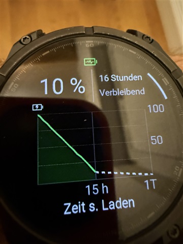

Ich habe die Uhr neu gestartet und auf 22.38 aktualisiert. Der Akku hält nicht einmal 6 Tage
Kein Garmin Share, Sensoren deaktiviert, kein AOD, Pulxiometer nur manuell...
Echt schwach...
Noch eine Info...auch das komplette Zurücksetzen der Uhr brachte keine Besserung

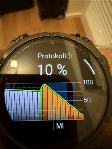

My battery life dropped from 14 to 10 days with the 21.41 update and didn't change since then

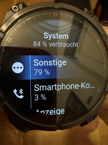

Ich habe mittlerweile alles versucht. Neustart...komplett zurückgesetzt...neustes Update....Akkulaufzeit weniger als 7 Tage...Fenix 8 AMOLED 51 mm...was kann ich noch machen? Ich bin sehr enttäuscht

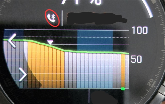

I have the same priblem with my Garmin Fenix 8 47mm. Yesterday a battery drop similair to the opener of this thread.
I think it's related to the Bluetooth connection between watch and phone. I was driving with my car, phone connected to watch and also to the car.
When checking later the battery usage graph hour by hour where the drop was, I could see the phone connection bluetooth sign by the graph in EVERY of the hours. The drop was 2%/h, and the watch was in normal watch use, no activities etc on.
Please check why the Bluetooth connection stucks and drains the battery.
