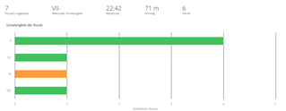

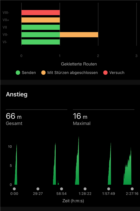

On the 5th of January it looked like that:
The elevation gain was measured and all routes where started automatically. So the start of the climb was detected.

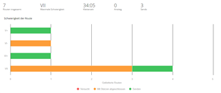

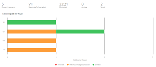

On the 10th and 13th of January then i had to manually start and end every climb with button presses:
No elevation gain was measured and i assume, that this is the reason that also the auto start and end of the climb is not working anymore.
So it seemed that between the 5th and the 13th something changed and the watch is not recording anymore the height gain in the indoor climbing activity.
