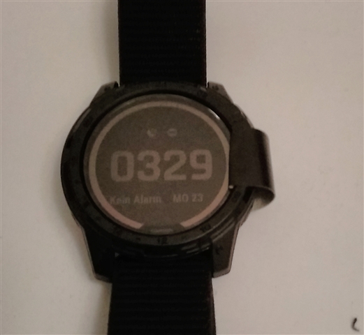

  • I'm quite successful using a protective cover for the housing of the unit where I covered the opening for the sensor with gaffer tape in a way that only very small openings are in to direction of the buttons. I'm not sure how ever if that will help you under those quite extreme conditions, moisture will find its way I'm sure. It prevents wind pressure e.g. from downhill driving to press onto the sensor...Maybe it helps to fix a little piece of sponge this way...
