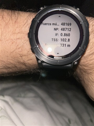

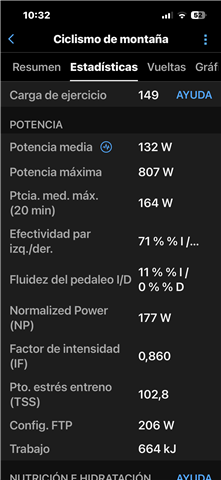

Here is the comparison of the data on my Fenix 7 and my Edge 840
| Fenix 7 (V26,9) | Edge 840 (V30,18) | ||
| Shimano power meter + Force Vector Viewer (IQ) | Distance | 107,3 km | 107,3 |
| Temps | 04:00:41 | 04:00:41 | |
| Vit. Moy | 26,7 km/h | 26,7 | |
| Vit. Max | 57,3 km/h | 57,3 | |
| Calories | 2449 Kcal | 2449 | |
| FC moy | 124 bmp | 124 | |
| FC max | 149 bmp | 149 | |
| TE aérobie | 5 | 5 | |
| TE ané | 3,3 | 3,3 | |
| Charge | 462 | 461 | |
| Cadence | 76 trmin | 76 | |
| Puis. Moy | 148 w | 148 | |
| Puis max | 680 w | 680 | |
| Force moy ?? (NP) | 187 w | 187 | |
| Force max ???? | 55677 | ||
| NP ???? | 46836 | ||
| IF | 0,889 | 0,889 | |
| TSS | 316,5 | 316,5 | |
| Equilibre | 51% - 49% | 51 - 49 | |
| Accension | 1260 | 1260 | |
| Descente | 1244 | 1244 | |
| Chgt vit av | 75 | 75 | |
| Chgt vit arr | 764 | 764 | |
| Source | Edge 840 | ||
