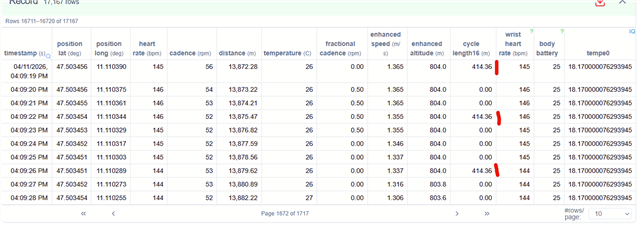

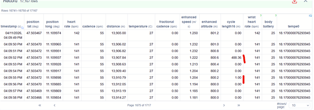

    Regarding the GPS lateral jumps and altitude inconsistency:
    • I've checked the FIT file with https://www.fitfileviewer.com/
    • In the column "enhanced altitude" in the section "Record" I see only ever steadily decreasing values, consistent with the terrain.
    • Same for the "GPS meta" section.
    • Recording interval 1s (consistent in both sections)
    I can only conclude that these jumps and what you see in the screenshot from the initial post is so short that is is never recorded, but only used for calculation.
    However, the recorded data also suggests that there is no error in the altimeter, because the recorded data seems consistent. I did not check the whole file though.
  • Hang on, I may have found something: There is a column `cycle length16` which shows strange and inconsistent data:
    The value makes no sense, but the timing (a few seconds apart) seems consistent with the unit's "lateral jumps" and altitude glitches.
  • length16 is the circumference of the cycle wheel. Try disabling the auto-calibration, and set it fix. Possibly your speed sensor needs a new battery.
  • That possibly does not make sense. It was a hiking activity (see initial post), and ~400m circumference seems way off Sweat smile also, on this page they say it's "distance per stroke"? And it is not recorded consistently, and it seems to have strange values?
  • ... however, the length16 anomaly is unlikely related to the compass issue.

    Well, more specifically it is the distance per cycle, which can be indeed a stroke in rowing or water sports. I thought your activity was cycling, not sure what it is doing in your hiking activity.
  • Do you have some data in the Cycle Length16 field in older hiking activities (or in activities from the other watch) too?
