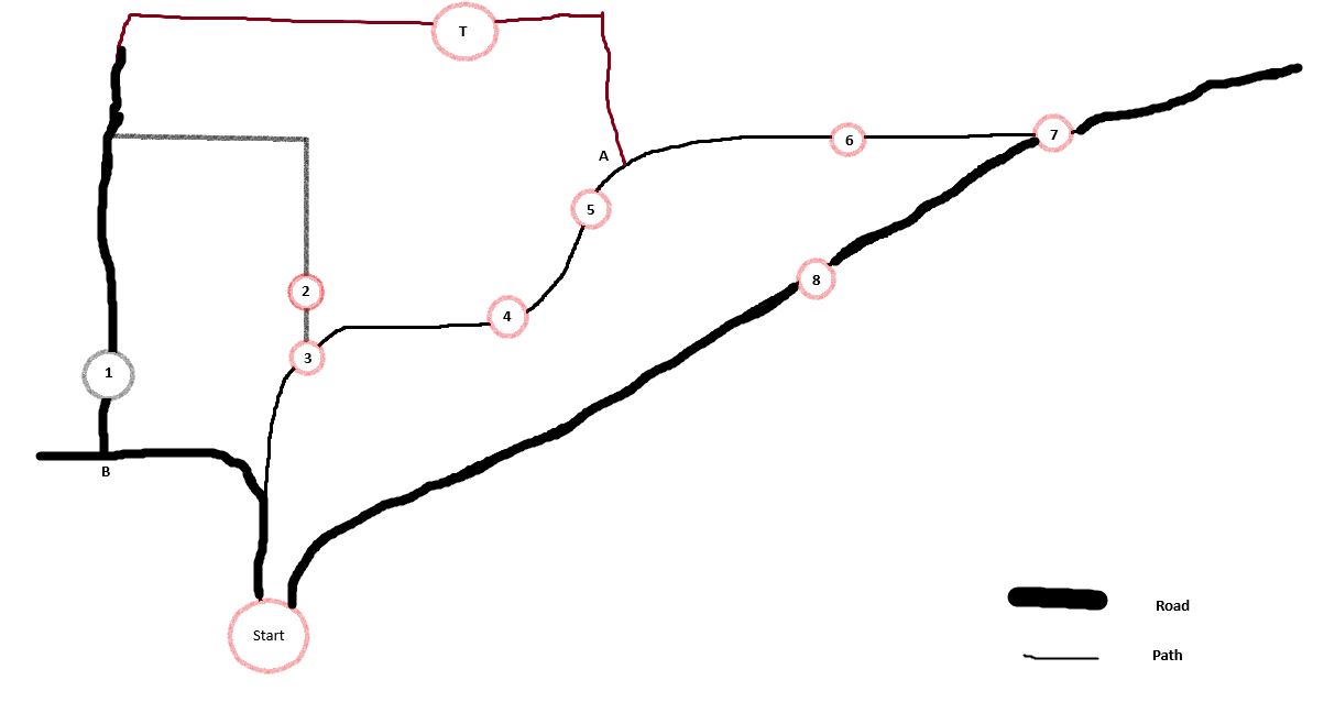

To visualize what happened, I drew a picture of my route.
I started at startpoint "Start" and the target was "T", with the calculated route via "A".
I did not take the calculated route, and instead walked the street around the corner, and then further up, to get to target "2" from the other side, but then the problems started!
  1. Recalculation of the route caused "Route calculation error. Missing routable roads in this area" – Restarting impossible
  2. Took a side-path back down (was getting dark), tried route back to start - "Route calculation error. Missing routable roads in this area"
  3. While standing still, tried route back to start with success
  4. Walked into the opposing direction instead, because I liked the longer route back home, recalculation happened with "Route calculation error. Missing routable roads in this area"
  5. Restarted route back home with success
  6. Walked in opposing direction further again, recalculation happened with "Route calculation error. Missing routable roads in this area"
  7. Restarted calculation home – map went dark with clear rendering issues, no paths visible, a few grass areas on dark but everything seemed off
  8. While walking and going into navigation menu, watch crashes and reboots. After reboot the map was still dark and the “Current Pace” voice alert is played 5 times in a row afterwards.
Few observations here:
  1. Walking on the street does not protect you from an error that I’d expect somewhere in a nomansland at best, but I’d even expected Garmin navigation to work off-paths originally
  2. On some paths I was unable to restart the navigation at all, like at “2”
  3. Not sure if standing still was the solution, but I did so on 1 and 2 as well with no success
  4. Walking into the opposing direction causes a recalculation, rightfully so, but how can it be that a RCE is caused at “4” just a few meters back from the starting point “3”, while at “5” you can start routing again through “4” with no problem at all?
  5. What has happened at “7” and “8” is totally unexplainable and it seemed like the map corrupted itself at that point. Got it working later again after switching topo off and on again and restarting
I’m at a point where I’m wondering if anybody is really using Garmin for routing at all. I’ve never imagined that products that pretend to be cutting edge in terms of outdoor navigation are so unreliably, beyond anything usable.
And this is an error that not only occurs with Fenix 7, but also Fenix 8 and Fenix Edge products in one form of another. In my case it is clearly a bug, so I bet in several other cases it’s also one, rather than actual non-routable roads.

  • Thanks.
    It was the normal walking activity.
    I've looked up the details on openstreetmap and will give you the attributes based on the numbers in my diagram:
    • 1. Asphalt street, highway=residental
    • 2. grade2 track with surface gravel, highway=track
    • 3,4,5. grade2 track with surface fine_gravel, highway=track, access agricultural
    • 6. grade2 track with surface gravel, highway=track, access forestry
    • 8. sidewalk with surface paving_stones, highway=path, foot designated
    Paths were all showing up in TopoActive, nothing new here in that area. And given that I could restart the navigation on paths that were previously declared as "missing routable roads" screams like unintentional behaviour to me.
