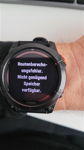

Just installed the new update on my Fenix 7 Pro, went to walking, navigation and then first clicked "Around me", went back because I did not find what I wanted, clicked favorites and picked a restaurant about 3.3 kilometers away.
I get the usual "Not enough memory" error, which is funny, because the watch was freshly restarted after the update.
Afterwards I got an immediate crash and reboot.

  • I think I have fixed it by coincidence.
    What I did (and some steps are random, possibly not in exact order):
    1. Connected Fenix 7 to PC and deleted all maps except Europe Central
    2. Went into"Walking" and tried navigation, same issue again
    3. Disabled "Worldwide Basemap DEM NR" an rebooted
    4. Disabled "TopoActive Europe"
    5. Enabled both again
    6. Another manual reboot
    Now the navigation works again and I had no crash anymore so far! and not "not enough memory" error.
    I've even managed to re-enable all layers again which I had turned off in the hope to save memory, and set the map resolution/quality from low to standard again.
    It even works for a 15km route, while it failed before even for routes with a few hundret meters!
    So this must have been some kind of bug, not sure by what it was caused.
