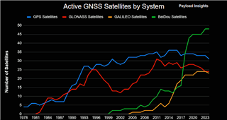

the Chinese BeiDou GPS system is available over North America
and the international version of the Fenix6 series has the option for that system, just not the Fenix6 sold in North America?
Please enable it before discontinuing firmware updates?
Glonass from Russia is an option so it seems silly BeiDou is not
Other watch brands have BeiDou option in North America and the Fenix8 has it enabled?
garminrumors.com/.../
payloadspace.com/.../
> The Space-Based PNT Advisory Board put it bluntly in its 2023 summary report saying, “GPS’s capabilities are now substantially inferior to those of China’s BeiDou.”

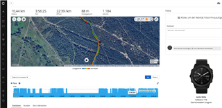

    Tactix Delta (corresponds to the fenix 6x) - Identical in construction. A hike ! Which usually gives even less accurate readings than running due to the lower speed.Outward and return journey on the same road :
