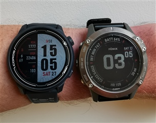

  • Today's battery life 'drain of shame' update - after a relatively good couple of days with around 11% consumed a day, I've lost 22% since around this time yesterday. Just 30 minutes GPS used yesterday, 1 hour indoor cycling today. The Coros Pace 2 also worn with identical usage, and identical ANT sensor connections ie power, speed, HR used 8% in the same time period (which is pretty crazy as it's smaller and thinner so must have a lower capacity battery)
    That is an 80% drop since full charge 5 days ago (100% Thursday, 20% Tuesday)
    19.20 / no wifi (always off) / no Pulse OX (always off) / Sleep  power saver is 10PM / 730AM / No CIQ watchfaces, just default / 24 hour oHR / BT On / maps and navigation features never used
    Was at 42% yesterday
    64% on Saturday
    100% Thursday
    PS: There is method to my madness doing this daily update publically.... ;)
