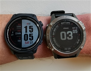

  • I do not actually use maps much at all too be honest - I cannot see how that could be responsible for battery drain as maps only are displayed during an activity if such a data page is selected. But in watch mode like in my photos, then maps cannot be running so cannot (should not!) be parsing the map data in my view.
