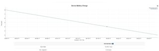

    So this morning about 20 minutes before a 42 minute run this was the battery status of both.
    Before (at that time of day my F6 is still in sleep power save mode)
    After (my Fenix 6 ran out of power at about 37 minutes)
    So Pace 2 used 5% on this run (which IMHO is quite high really) but Fenix 6 used it's last 10% and I lost about 1 mile from the as the F6 shut down mid run.

    Yes, so yesterday about 19 hours ago my Fenix 6 had 15% battery, and then dead mid-run.
    And a quick look at Coros wrist HR vs Fenix with HRM Pro (you can see when the power cut out from my Fenix 6 there!) - normally optical wrist HR is unusable for me due to cadance locks, but the data there looks fairly OK.
    And it was in low power mode from 10PM. But charging every 5 days is usual for me since 19.20. Too be fair, even before 19:20, 7 to 8 days maximum before needing to recharge. But the battery loss since 19.20 is a very clear and obvious pattern.
