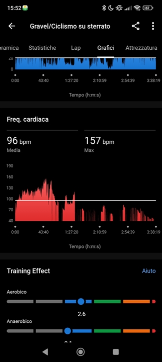

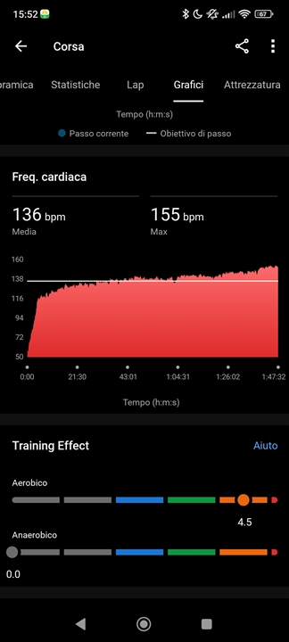

  • I use Fenix 24x7 + Edge 530 + HRM Dual Premium. Usually I start a cycling activity only on the Edge 530 but I have troubles with the HRM reading because It is discontinuous. I am thinking there is some miscommunication due to the presence of the Fenix that I use just as watch. I am not taking into account problems with the strap because starting an activity by Fenix the HRM graph is perfect. Next time I will try disconnecting the strap from the Fenix while cycling. Have anybody experienced something similar?
    On the top a running activity on Fenix
    On the bottom a cycling activity on Edge
