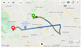

My last 2 walking routes seem to be way off the mark when viewed on a map, whether in Garmin Connect or Strava. One had me starting 5 miles away.
Any reason for this? Is the GPS accuracy really bad? Are there any tips to improve accuracy?

  • Back on this topic, when I switched the watch on this morning (I usually turn it off when not using it) and looked at the Map screen it showed the last position I was in yesterday (my driveway) but then when it got green gps lock, jumped to a position about 5km NE of here and stayed there for 10 minutes or so, I left it outside for a while and it corrected itself, but still seems to be some weird stuff going on.

  •  (3 jan 2021) Thank you for mentioning Glonass, my run's trajectory shifted about 5km north east for the start point, the pace and position on map when running were all over the place! I am using GPS+Glonass, I have friends with the same watch (Garmin 6X pro) and no problem... so guess giving a go at GPS only might fix it.  (UK)
  • I have a near new Fenix 6x. My CPE shows current (not expired), but tracking is way off. Location jumping all over the place during my run both on GPS+GLONASS and GPS+GALILEO since the last watch update. I always check I have a signal before I start, but it gets lost along the way, despite having minimal obstructions around me. Will try GPS only on my next run.
  • Still having issues, drove 2km from Home and started a walk in a conservation park, had walked for about 20 minutes when checked the map and realized I was waaaay off track (maybe 10km). I recycled the GPS (GPS > GPS+ GLONASS) and it eventually caught up with me. Walk start and finished in same location, finish is correct.

  • This is definitely not a fix, didn't work again properly. Sat outside and looked at the map, was at the right place for a starting point, when I started the walk, all of a sudden I'm several km away NW of actual location and took minutes to return to normal.
  • I had the same thing happen yesterday -- but only for about half the of the run.  In the middle of a ~4 mile workout it regained the CPE file (which now shows "current") and the track returned to normal.  The first part of it, however, was a hot mess and all over the place -- 1000' or more off in places (!!!)
