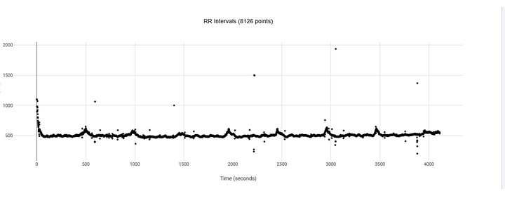

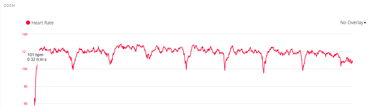

  • I love AlphaHRV, but unfortunately AlphaHRV doesn't work for Swim activities, internal recording should be better than over the air streaming by Ant+ or BLE, less interference, less packet losses. And you can always use session start timestamps and elapsed time to get RR data in sync. Check my interval.icu Hybrid NN/RR percent and HR Swim Memory streams, and Swim NN/RR Percent custom field

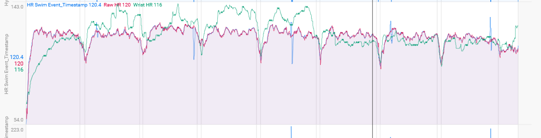

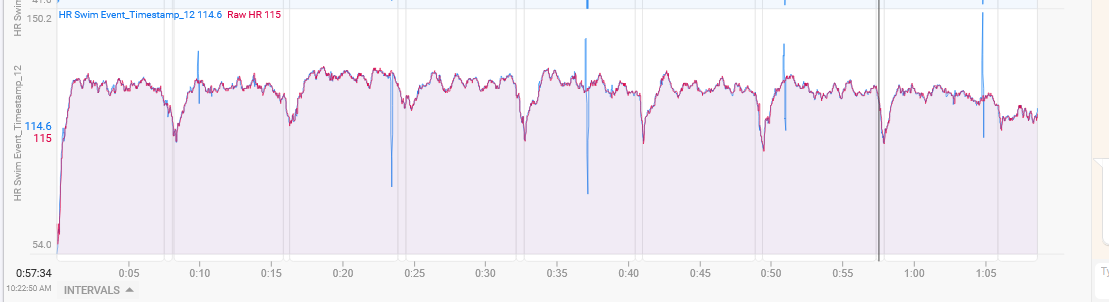

  • Raw HR vs HR Swim Event_Timestamp
    Proof of concept : HR Swim Event_Timestamp Custom Stream, calculated from message 132 event_timestap fields converted to rr, converted to bpm
    ligthly filtered and well synchronized.

  • In this case a open water swim with a triathlon top and FR955+HRM-Pro.
    Can you try it with your setup?
