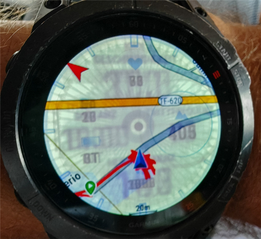

My epix Gen 2 (purchased January 2022) has developed significant OLED burn-in after approximately four years of normal use. Persistent dark patches and ghosting of interface elements are visible regardless of watch face, brightness setting, or software reset. No physical damage.
Garmin Iberia's out-of-warranty response is a flat €353.06 fee, which covers either repair or replacement at their discretion — decided after physical inspection, with no itemised breakdown beforehand and no right to confirm before they proceed. Replacement would be with a refurbished unit.

  • Its an OLED screen... all OLEDs have burn-in issues after x years. My Epix Gen2 (purchased week after release) has some noticeable burn-in.
    Fenix 7 uses MIP display that has 0% of burn-in probability, because the fundamental tech is completely different.
  • My Epix Gen 2 was purchased 20 Jan 2022 and exhibits no signs of burn-in or other AMOLED anomalies.
    As with ALL AMOLED displays, burn-in artifacts - to a greater or lesser degree - are inevitable eventually.  How soon (if ever) before one observes this effect will depend strongly on user selected brightness level, use of AOD (Always On Display), and any prolonged display of an unchanging screen.
    Sorry you have experienced this with yours, but as it is out of warranty, it sounds like you are being offered a fair response from Garmin.
    HTH

  • Mine is from 18-01-2022 and the burn in started well over a year ago.  I did not contact support. The screen is somtimes completely illegible with small letters.
  • Did you use AOD or highest brightness?

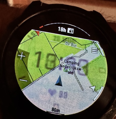

  • Same here after 3,5 years on Epix 2 Saphire:
    Never used the main watchface in always on mode, lightning time just 4 seconds and i have to move my arm fast to activate, so it's not lightning very often. How can this be on a about 1.000€ watch? Do they use the same "quality display" on the > 3.000.- € Marq too? Rolling eyes
    "Always on" i use only during activity (bicycle or windsurfing), where meanwhile (with the newer firmware versions) it dims so much that it's unusable outdoors.
    Astonishingly, the watchfaces used as "always on" didn't burn in, just the rarely used main watchface. As i don't use maps, one might think that it's not a big problem, but brighter parts on other contents (as letters or numbers) get partially affected too, so visibility is more and more affected.
    What's astonishing too: The contours of the clock hands are about in the same amout burnt in as permanent fields, even if they stay hust one minute per hour on each position. Strange.
