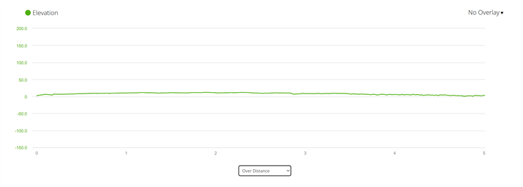

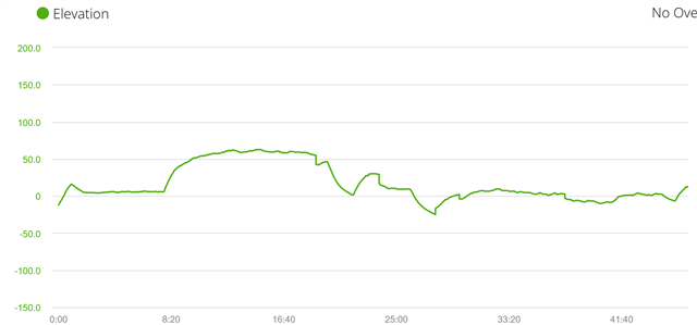

I ran a flat 5-mile route parallel to a river.
Recent Run (Faulty): 119m Elevation Gain. In this part of the run it says I climbed 40m in approx 1/4 mile - this is a flat route.
Previous Run (Correct): 24m Elevation Gain (Same route, same watch, before the issue started).

I sent this data to Support, but they replied stating the device is "working as designed" and that the drift is just due to GPS ping accumulation. Specifically, they said:
"The only time we'd consider things unusual is if the elevation graph in the activity as well was wildly inaccurate, but the example you've provided indicates normal readings, so in this instance the Total Ascent feature is working as designed."
To me, a 400% difference on identical terrain looks like a clear hardware fault (barometer sensor failure), not normal GPS drift.

  • Yeah, I wear it all the time and swim occasionally. Garmin support were incredibly unhelpful too...suggesting it was normal for me to climb 30 metres up in a few metres along and also for me to be 60 metres below sea level when running along a river.
