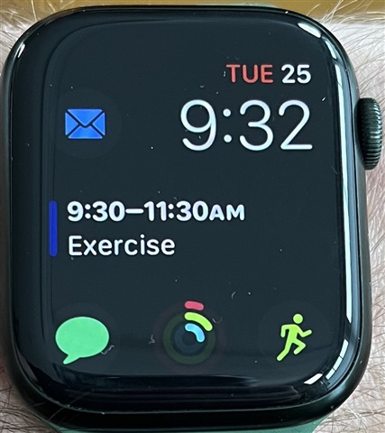

The Apple Watch 7 alternates between two states (apologies for the dust in the pictures). This is the awake state:
And this is the awake-dimmed state:

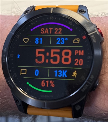

The Apple Watch 7 only alternates between these two states. It is always in one of these two states so I thought when Garmin says AOD it would map to the Apple Watch's awake-dimmed state, but that is not the case in non-activity use. In my general use, my watch moves between three states. This is the awake state:
This is the awake-dimmed state, but it only stays in the following state for a split second as it transitions to the third state:

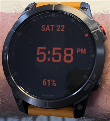

And this is the third state, the Garmn-AOD state:

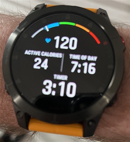

If I am doing an exercise activity, the Garmin only alternates between the awake and awake-dimmed states. This is the awake state:

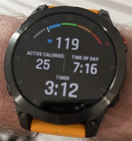

For all the reasons articulated in this thread above my post, I don't understand why Garmin has chosen to not mimic the behavior of the Apple Watch (5, 6, and 7) and simply alternate between awake and awake-dimmed at all times. Or at least give the user the option to do this, wilth full understanding that this would severely cut battery life. In my opinion, that decreased battery life is totally worth it given the tradeoff of the screen; if I did not want that tradeoff I would have bought a Fenix 7X.

You've installed a 3rd party watchface. It will need to be updated by the developer to support the new AOD modes. Try a built in watchface.
Maybe I'm confused. Is there no option for the display to turn off completely during exercise like my fenix 5x does? I don't need the watch face on at all while I'm running, unless I turn my wrist to look at it.
Thank you. I can replicate this behavior on the built-in watch face as well: that in general use the watch face alternates between three states and the Garmin AOD state is less detailed than the awake and awake-dimmed state.
In my original post I should have referenced a discussion exchange I had with the developer (who is totally awesome) and that discussion is here. To summarize that discussion, the developer is only allowed to use 10% of the pixels on the screen so the developer can not alternate between awake and awake-dimmed (and the Garmin built-in watches can't alternate between awake and awake-dimmed either). So I think my point is still valid that the Garmin AOD behavior is different than the AOD definition employed by the last three generations of Apple Watch, but perhaps my point should have been in a different thread.
Sean
If you use the native garmin watch faces the watch face turns off completely in the third state. I try and use their native watch faces as they're generally easier on the watch performance wise. I noticed pretty significant lag using gearmin or datalover when trying to go to widgets on my fenix 6x (and every watch prior).

It only turns off completely if you keep your watch still for 60 seconds. Otherwise it stays on (if you have the AOD display setting on that is.)
