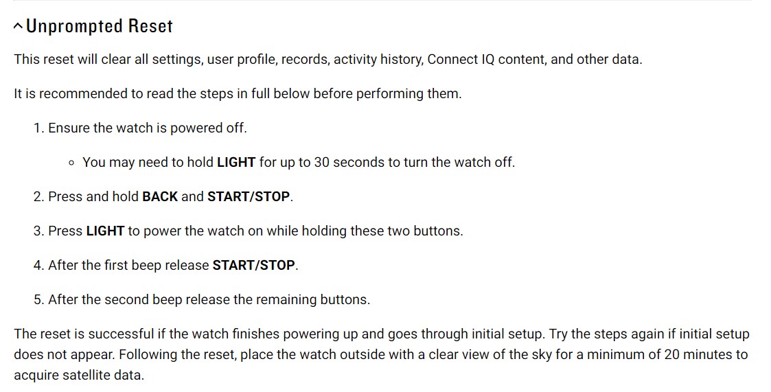

    4. Then complete the Spotify set up with these steps: Instructions to Sync Spotify Music to the Enduro 2
    If this is still not working, at what point does this fail? There have been some complaints of freezing when connecting with WiFi. So if this is freezing when the music is syncing, this may be related. However is the app is still failing entirely to open,  would recommend trying the factory reset with these steps:
