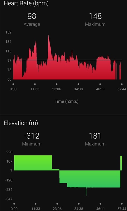

  • Same here, bought the watch to surf and the accuracy is ridiculously wrong. When I watched the summary of the session, got 39 waves reaching 50km/h.
    Even the software is wrong! The summary said maximum speed 40km/h and in the individual wave information there was a wave reaching the 50km/h recorded. Again in the totals shows that I had a total distance of 6120m, which even if it is with the paddling is pretty much impossible. Also sums up my max speed of every wave ( don't know what for ) which is 430.114km/h.
    I can only find everything I just wrote ridiculous for a 400€ watch.
    Bought it because had really good review from a friend from the forerunner 245, but this one is simply useless to surf.
