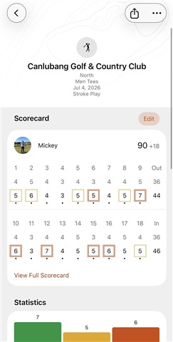

Out of the last 10 rounds, 3 of those did not have the view shot map which I really check since I like to check my yardages. I also noticed that after I saved or ended the round yesterday, the watch restarted by itself. So when it rebooted, I checked and had to save the round once again. It recorded my round settings except for the view shot map in the garmin golf app
