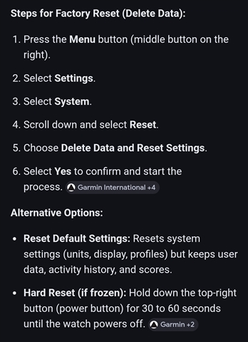

If your touchscreen becomes unresponsive after a software update (often triggered by pairing with an iPhone), factory resetting the device multiple times can temporarily restore functionality.
Here’s what worked for me:
  1. Perform a factory reset — not just once, but 3 to 5 times if needed.
  2. Wait at least 5 minutes after each reset is complete. The touchscreen may suddenly start responding during this time.
  3. Once the touchscreen is working, go through the initial setup but DO NOT pair the watch with your phone.
  4. If you pair it with a phone, the watch will auto-update the firmware again — and the touchscreen will most likely stop working again.

  • How did you do a factory reset if the screen doesn’t work?
